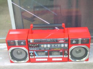

Good idea, Im gonna have to try that with my L30.JVC Floyd said:my lasonic l30k .
I put some polyfill in the speaker cabinets . huge improvement in the sound , it was good before but now it really sounds smooth and hits hard . prolly my best sounding lasonic lol ,
Thanks Floyd, Im gonna do it. I have some polyfill already, just never thought of doing this.JVC Floyd said:its worth the time , you don't need much just enough to be fluffy inside but not compacted , takes the hollowness out of it and the bass sounds fantastic really the whole box sounds farking awesome . with a strong line in signal its as good as any other lasonic. my 1 piece lasonic's just can't hit as hard.
