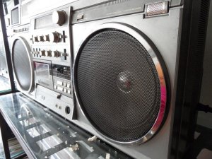

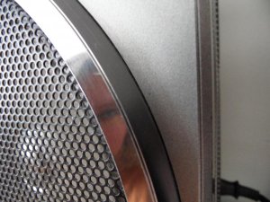

So, at first I hated those stickers. Now I think I love them!!!
Look! Look! Look!!!
