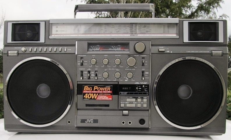

First off congrats.
You say the vu meters are pegging out.
Is that with every source or just line in from iPod?
If it is just on the line in that leads me to my next question. Is the phono / line switch stuck in the phono
Position?
If you answer yes then that's the problem.
Best of luck on a great find.
We will get her 100% with some help on here
The line/ phono switch is a typical problem with this model
And can be remedied with switch cleaner and lubricant.
Or just have the switch replaced
Position?
