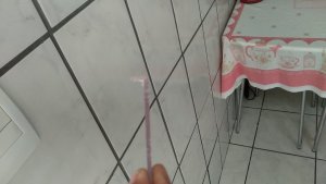

hardmen

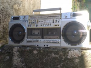

Door I get from Eric and my attempt to make a door window from scratch.
IMG-20210203-WA0088.jpegIMG-20210203-WA0090.jpegIMG-20210203-WA0080.jpegIMG-20210203-WA0084.jpegIMG-20210206-WA0068.jpeg
IMG-20210208-WA0075.jpegIMG-20210208-WA0077.jpegIMG-20210206-WA0073.jpegIMG-20210206-WA0071.jpegIMG-20210212-WA0126.jpegIMG-20210213-WA0010.jpeg
