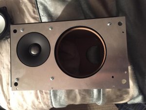

Bought 2 Paradigm speakers that will be modified to fit like the original speakers. Fittting the original front grills Is the real chalange. The reason for this project is the bass missing with the original speakers. The Paradigm produces incridible bass and amazing overall sound.
Will I call it a Pana-digm or a Para-sonic boombox now? 😜

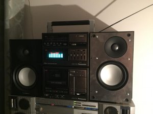

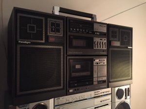

Finaly getting started on my Paradigm speaker modifications.
Picture #1
Inlarging the tweeter hole to right side to move tweeter to match original grill mid speaker position

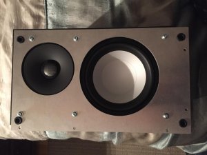

Picture #2
Fitting the new alluminum plate and checking tweeter position

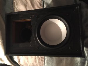

Picture #3

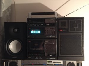

Tweeter, woofer and plate in place. So far so good

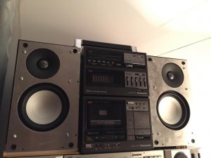

Picture #4
Speaker in position.

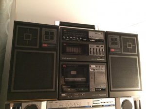

Picture #5

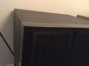

Trying the original grill on. Yess!
Picture #6
Good flush fit

JVC Floyd said:
The devil in disguise , I love it , fark the old speakers if they suck it takes work but its the biggest improvement you can make ,and these compo boxes rule when they are tuned and tweaked and can farking waste a 1 piece box.
Disguise, why not? It was alloween not so long ago right? ;-)
You are right. It does take some work and fine tuning... but the result, the improvement is like going from black to white. No grey zone here.
I kept the original boxes if I ever want to go back to listening to music from cardboard boxes... :lol:
In 3 words... IT KICKS ASS!!! :rock:

Norm1968 said:
The final result. My RX-C300 Pana-digm BB
I bet that kicks ass now mate congrats, best mod this year.. i agree with Floyd once modded these compos can't be beat, put some panasonic rx 60 drivers back in my pc5 and although not high end speakers like you'rs it's better than the m90 by far and there only 4"" drivers lol
