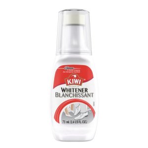

I've heard that tennis shoe whitener (the stuff that's applied with a soft sponge on the end of the bottle) works wonders:View attachment 28847
It's not a paint as such so it shouldn't affect the sound of the speaker. You just keep applying coats until you get the colour restored.
^ I actually have some of the sneaker whitening. Never thought to use it on my speakers instead of sneakers.....
Great idea James!
I hate painting...
$3.46 at Walmart for 2.5 Ounces
$3.46
$1.38 / fl oz
FREE shipping

The issue with using shoe polish (either white or black) is there's no even flow when using it directly out of the bottle. If you're planning on using it, which I wouldn't recommend since I tore a speaker using shoe polish, would be to squeeze it out of the bottle into a cup and use a paint brush to apply. I've used flat white spray paint with good results.
^ Yeah, what Jerry said. :yes:
