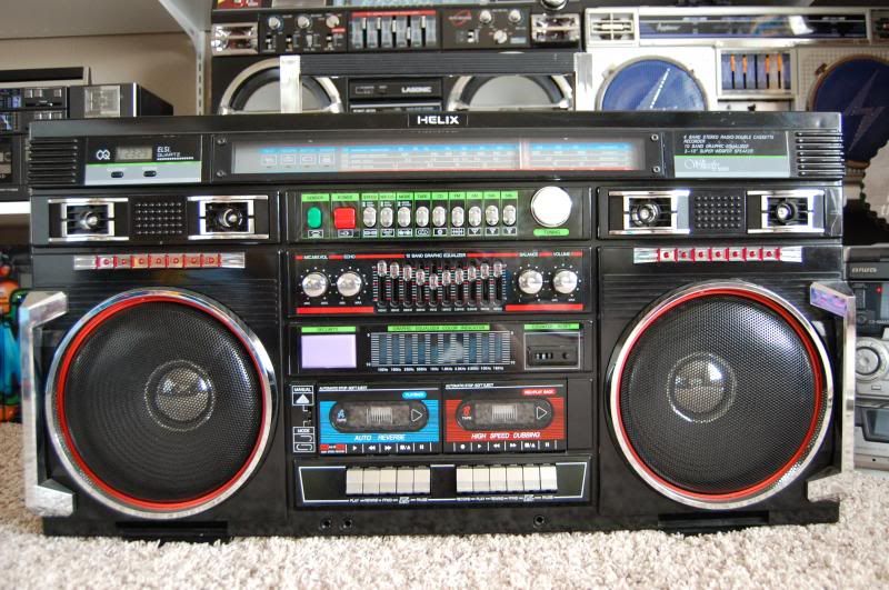

Arh, thats interesting. My wheely has a faint hum when plugged in, is that fairly common on these?blu_fuz said:Well when I picked it up it really wasn't working at all. The lights came on, tapes weren't playing at any kind of listening volume or sound quality, had the typical transformer 'buzzzzz' when plugged in, and the battery door is missing.
The plan was to hopefully find a buyer on Boomboxery for it but now after going through and figuring out the issues, it is just about 100% fully working!! Went from door stop to shelf queen.
I think it is staying with me for now.
.Thanks Joeblu_fuz said:Yep, they will all pretty much have it unless you fix it. It hums as soon as you plug it in, it doesn't even need to be powered on to hear it.

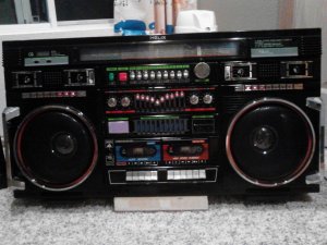

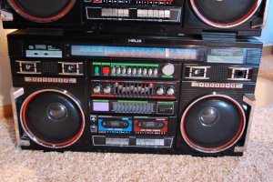

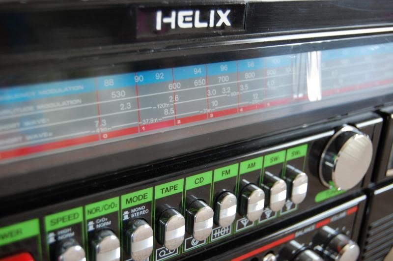

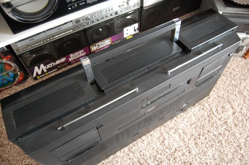

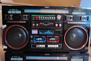

Keep it!! It looks great!blu_fuz said:I should have turned the flash on or used my tri-pid for the pics, woops!
I'm having a heck of a time convincing the wife to let me keep this Helix Wheely.....
