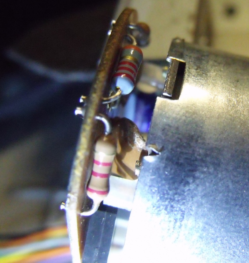

Ahh Norm! Underneath the PCB!
Checking the underside of the motor PCB there IS another one the same!
This will make life easier.

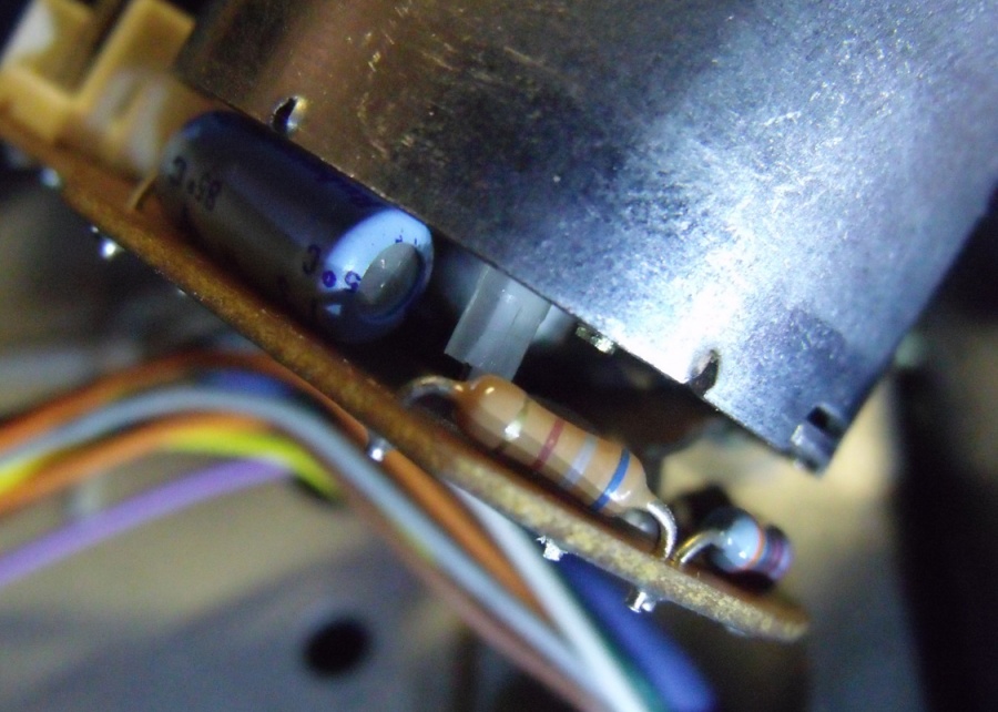

One of the round caramel coloured things has a couple of scratches as seen below:
I'm going with your theory on the brown band too. The resistors in the motor are a completely different colour cast to the ones on everything else on VZ.
:w00t: See, I just KNEW we would find it. All you need to do now is measure that value and you'll know what to stuff in there. Keep in mind that the blue-gray combo will always start with 68--. So the rest is the multiplier. So if you read 703 ohms, don't kill yourself trying to find a 703 ohm resistor. There is some error always introduced through the leads, measuring equipment accuracy, tolerance of the resistor, etc. Whatever the reading you get, the closes 68-- value combo will be the one. So looks like we no longer have to guess. Measure that resistor and put the proper one in there. As for that caramel looking thing -- that looks like a ceramic capacitor.
Well, I said it looks brown because red really looks red but then I'm looking through the filter which is my computer screen. You see the resistor that has 3-red stripe? Now THAT is red. Anyhow, the color code is the only thing that is important to you since I'm virtually certain that the resistor in there is a standard one without special purpose. There are others that are flameproof, fusible, and different compositions such as carbon, wire-wound, metal film, etc. For the purposes of which you need, a standard 1/4watt 5% resistor is all you need. The 5% is indicated by the gold stripe. Since it costs more than 10% (or worse tolerance) resistors, 5% resistors wouldn't normally be used unless they wanted the tolerance to be that precise.
Anyhow, if you replace the resistor and it continues to work exactly like it was BEFORE you broke that resistor, then perhaps it's working properly (the motor anyhow) and you need to focus attention at the actual speed control circuitry, which is on-board. to fix the speed issue.

Should I be concerned about the scratched ceramic capacitor?
As far as how the record player was working before I broke the resistor in the motor it was playing perfectly but just a little slowly. The issue since the resistor broke seem to my untrained eye/ear like it was the speed-governor or something for the consistency of the speed, more so than the actual speed which the pots on the main board control. If that makes sense.
Thanks again Norm, as long as I'm moving onward and upward and not backwards I'm happy!
Highly doubtful that the capacitor got damaged from a few external scratches but if you are concerned, you can go ahead and change it. I don't think it's critical -- my suspicions is that that capacitor shunts noise to ground.
