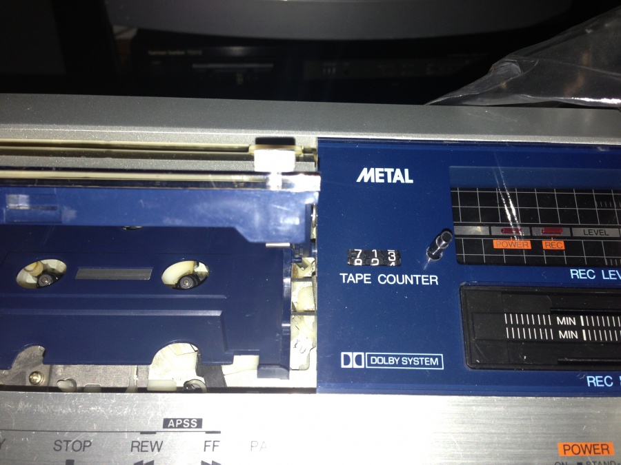

Hi Simon, can you put up a pic of the cassette tray. When I open mine it looks like only half of it comes up and the other half is still down. It doesn't look right to me. :hmmm:
Alberto
well after further inspection it looks like the bottom cassette tray has 2 pins on the left and right sides that have broken off and will have to be repaired. :sad: But guess what guys, everything works, cassette,radio,turntable. LOL!! :lol: :lol: :lol: :lol: :thumbsup:
Those broken pins can be easily fixed. Drill a hole where the pins were broken off and insert an Al pin with the same diameter of the hole and glue it. I used a little bit of 2K epoxy when I inserted the pin. I used the same broken pin and made a hole to tightly fit the pin there. I had to make adjustments for the slightly shorther length of it.

A Royce, can you or someone tell me if the pins just extend to the top cassette cover and just ride in the slots or do they extend further to the fixed/stationary holes on each side of the cassette tray? :hmmm:
From what I remember they extend to the slot. They don't extend more than 5 to 6 mm outward. Let me see if I can take a picture of it without opening up the unit.
They stay in the slot serve as a hinge.
Pardon me! Without opening up the box it was pretty hard to get a good view of the pin that serve as the hinges. Please see the pic :yes:

Chris already answered about the color difference. Those pins will break if one forgets to open up the unit without leaving the cassette door open. So always remember that after you fix it. I had to open up the unit several times because one way or other I ran into problems. Also be careful with the top PC board of the turn table. Two places of the board along one side are held to a V cut metal slot that can break the board if not careful. There is a small switch near the stylus advance motor also very fragile. This switch is next to the pulley holding the cable reel. :yes: :-D
