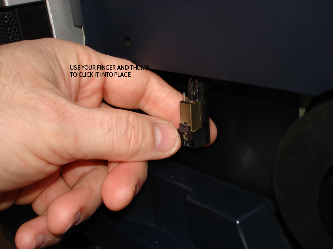

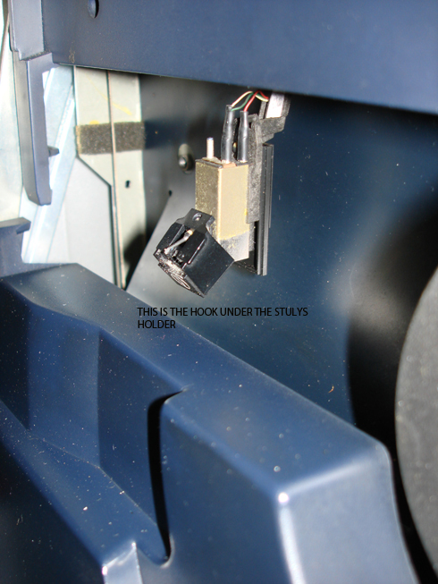

Here are some photos of the stylus how its fitted. As you know there are small hook like bits of plastic at the top of the stylus, this has to hook under the cartridge holder. I use my thumb and forefinger to make sure the stylus snaps into place, they do click! but the red ones don't seem to......

They, however, don't have the little tab to notch inside the cartridge, so they don't fit properly at all, hence the very low sound. Putting my one working black one in (same as yours in the pix) and it all works great, thanks to me properly inserting it, now you've shown me how!
