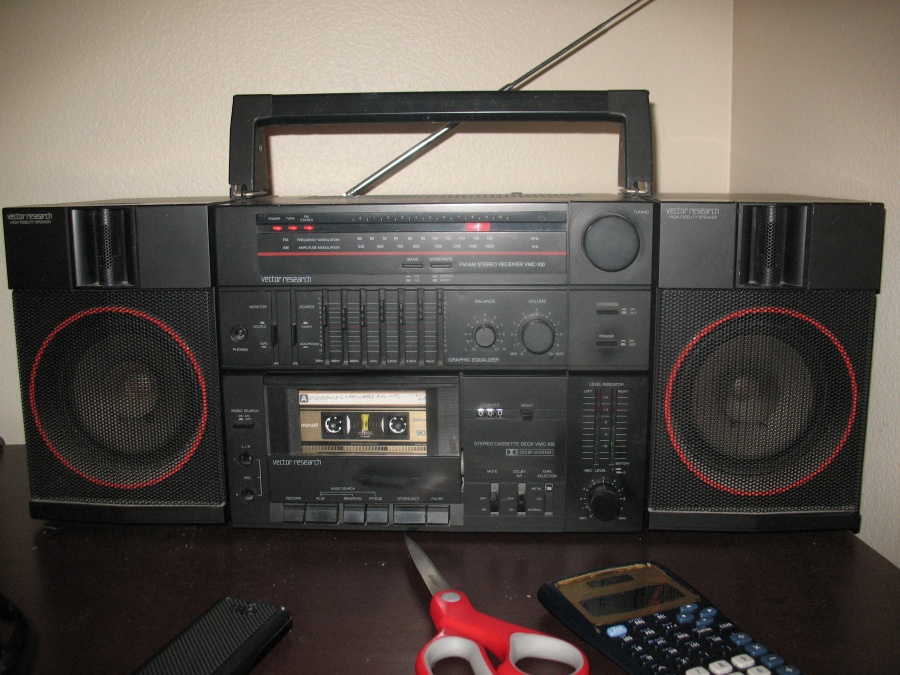

I have one of these radios and it is very nice. When I got mine it also had the problem that one speaker was a lot louder then the other. I replaced all of the wires on the back, and that fixed it.
Also I do have a question about the music search. I use the tape deck on mine all of the time, but the music search button does not seem to do any thing. Do you know what exactly its supposed to do?
Here is a picture of mine:
JustCruisin
The music search might only work on pre-recorded cassettes, not mixtapes? When the tape is playing you can press FFWD and it will go to the next song automatically then start playing..
Make sure that the Music Search is "on". Then, with the Play button still engaged, press FF or RW to skip a song or go back to the beginning of a song. Songs need about two seconds of space between them for it to work (most of the time).
