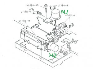

Hi, I'm new here, and I have exactly the same problem with my Aiwa TPR-990: the M2 motor does not receive power to run the soft touch system (the motor is in good condition). Could you solve it?
Tubejunkie could you solve it?
