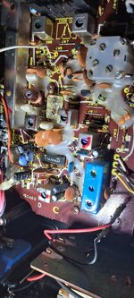

Yes I managed to get the front off just a Lil while ago very carefully removing the front. I snapped pictures. I didn't see any capacitors leaking, everything seemed as it should except for A LOT of what I'm assuming is hot glue on the board near the right speaker? Wondering if this is normal? It's covering easy 14-15 soldered components.
Maybe I missed something lol

Do you know if Toshiba typically used hot glue for components on their main pcbs? It looks kinda amateurish, and hoping that's not the cause of my problems.
caution
That's likely wax - and is on nearly every tuner board of the era. It's used to ensure the air core chokes don't get bent out of shape.
