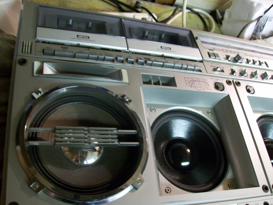

It's funny you should mention that Fatdog, & I feel the same. The horns have so much potential & mids are nice & clear. The problem is anemic woofers & tinny paper cone tech. The original BASS woofers are nice & punchy in a guitar amp kind of way but low end is gone. I picked some average 6.5" home speaker sub-woofers that had a nice trade-off between sensitivity & low frequency handling. Next, I needed to rig a tweeter that would fit the horn adequately & boost the treble response. I looked around in my basement & low down in a box underneath my bench was 2 little speaker cabinets that sounded like puke but the tweeters sounded good & natural. As it turns out the tweeters are a perfect fit & are more natural sounding, efficient & can handle more power too. Oh, & they are 4-OHM Infinity car audio tweeters from the late 80's when they were still using cone tweeters & a 6-db single cap x-over. PERFECT!!!
The donor speakers.
They were 30 bucks online & the tweeters were the only good part anyway. It's a cone tweeter with roughly the same characteristics as the old paper cone but it has a larger magnet & the suspension is some sort of polymer, almost like rubber. They are more natural sounding & the denter cap of the tweeters fits the horns like a glove. I'll have more pics soon:
Infinity Tweeter from donors compared to original SHARP Tweeter
19-BASS-Wooofer replacements 4-OHM

The front of the woofers. loaded into the GF-triple7-ZEEEE...*tear*...*sniffle*
Cpl-Chronic
:breakdance: Well, so far am pleased with the sound. It's close to balanced. I'm using the original inner super woofers as the outer speakers & they work quite well witht he new horn tweeters. Upper mids are still a bit muted but that should smooth out with the ESS 6.5's I ordered. I'm hoping the new outer woofers will make the mids a little clearer & warmer while boosting the 40-80Hz band...which is perfect for kick-drums & bass guitars. Plus, a light woofer with a foam surround is what I need for the rich mids to mate with the horn. Reggae sounds awesome so far & even rock & roll isn't tinny anymore.

Thanx goodman! :-D Keeping the horns was an improtant goal as horn laoded tweeters are 5 times more efficient than a naked dome or cone tweeter & the sharp GF horns are a decent design. The new sub-woofers were not very expensive but are decent quality & roll off at 40hz in a small sealed box(0.16 cu feet). They really 'pound' & the box rattles my bookshelf now. :afro:

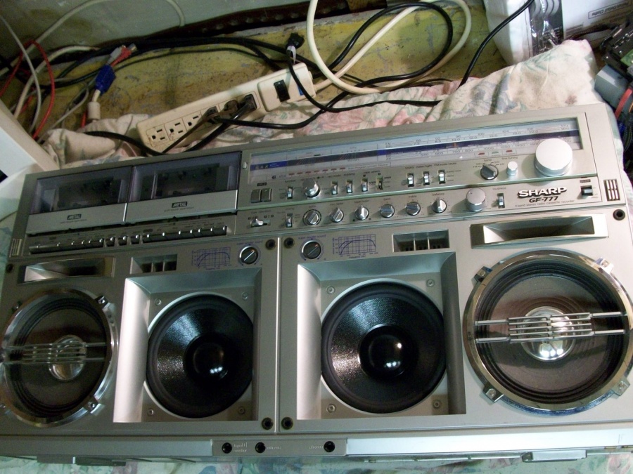

In the meantime, here's some more shots of the present modifications:
Here's a comparison of the original tweeter vs the new infinity tweeter. Both pics show the 2 drivers loaded into the plastic lens of the horn.
Original-Tweeter-Loaded
New Tweeter in PLASTIC Horn aperture
Notice the flat spot in the plastic opening to shape the coverage area of the horn. As you can see, the new tweeter dome actually makes better use of the aperture's size. The original dome is s=maller & leaves a larger gap for reflections.
As you can see from the pic below, the middle speaker is the original tweeter & has a much smaller magnet & voice-coil than the replacement infinity:
tiny-tweet-in-the-middle
The next photo shows the new tweeter insatlled:
Cpl-Chronic
Here is the left & right shots of the front & then the full front of the entire box:
Left side:
Right Side:
entire front panel:
