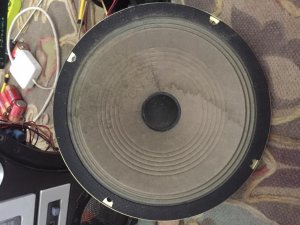

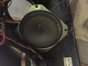

I was cleaning off the speaker grilles, and noted staining and lint on the bass/mid speakers. I saw a thread about acrylic paint which I will try. Does anyone have a recommendation on type of paint and/or color to match the 550? Just paint the acrylic on with a brush, right? Should I, and approx. how much, should I dilute the paint down with water?

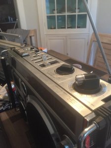

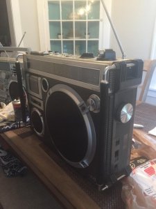

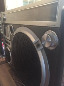

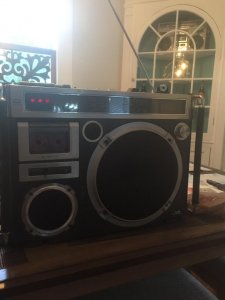

See some photos of her. I cleaned her up. I have strap coming from Blu-Fuz to fix the mixing handle. I'm on cloud 9. I love this box. I feel like a little kid!
I replaced a belt and got the cassette working perfect (except Record of coarse). I hope demag will clear up the cloudiness in the sound...but it not I can live with it if necessary....until I find the fix in the future. Bass does sound pretty damn nice. I like this Mono box for sure. Sound is great...especially on the radio. She GETS LOUD without distortion as well.
The last photo shows "moldy" plastic around the sliders. Not sure if there is a way to recondition this? I couldn't find anything on the forum, but maybe I wasn't using good keywords. I have some plastic on the top/side that looks a little moldy as well...but the area around the sliders really bugs me. Obviously some impefections on the box...but it is perfect...for ME! :yes:
