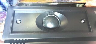

The tweeters are true 0.75" soft textile domes mounted to a slight wave-guide type flange.. Small ceramic magnets work well. Flat, even sound.
