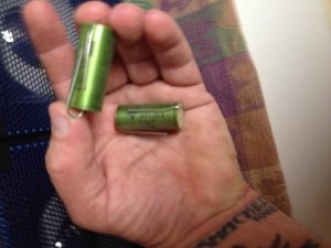

Yowza. The caps arrived today. They are huge. Like the size of m80s. Hope I didn't get the wrong size

Finally all set in the new house from end of october. Now I can get back on some projects. Of course I misplaced the monster caps (shown above) grabbed likely another 6 boxes since this all began. Can't wait to get started.

Cool...waiting to see what your next move is on those BOSE outers......They are designed to compliment the tweeters so no low pass coils are needed & would blend better as open full-range speakers...They are from a BOSE caddillac system so they are really good speakers...
