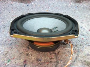

Who said anything about "ugly bandages"? That repair technique is suitable primarily because it's invisible once the repair is completed, unless of course you use too little spread or put the paper on the outside
, in which case then yes, they'd be visible close up. The only other viable way in this case is to replace the complete cones and those too are available in kits that include the shims for the cores as well as replacement dustcaps since they won't tend to stay concentric when there's neither the original cone nor the spring of rubber or foam to help.

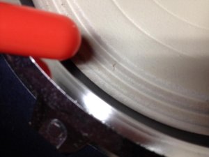

Can't see the repairs on the
outside of this, can you..
Me neither, and that's been repaired, the gummy area around the perimeter resembles closely the original finish but it's been repaired at 9, 11, 2 and 5 as you look at it from this view, with one of the patched ares having run from the cap to around half an Inch fae the edge. It's since been put back up to the device whence it came and although its opposite number remains unrepaired, the sound is as it was before with balance being bang on, no difference in range - such as it is in this low end mini box - and most significantly (from the POV of being paid) its owner couldn't tell by looking that anything was done.
It helps if the spider is still intact, it helped that these stay behind solid plastic frets which allowed little light through but the thing is; it can be done but I'd love to see - no, seriously, I would - how a foam or rubber suspension medium could go into a paper cone without the cone being removed to make the reduction to its diameter using accurate means. There'd have to be a space at least the width of the raised section of the surround so before trying that at home, best make sure & weld your scalpels together for accuracy and toe them out a little relative to each other.
Then there's the fact that speakers designed to run free edges by foam or rubber must have more coil travel to take advantage of the new suspension and also to avoid bottoming. Loads to work around but probably not impossible. Just a pointless waste of time and cash that would be better spent on more boxes.
