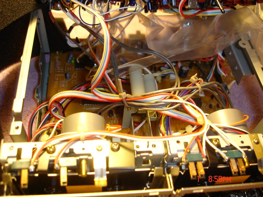

Yes! Now waiting for the belts to come in. Hopefully I will get it on Wednesday. I will replace belts and lube the flywheel. The re-assebly I might push till the Friday Feb 1 evening.

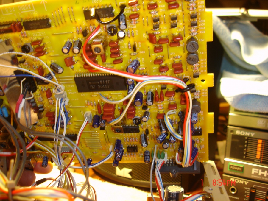

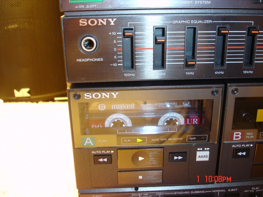

I was working on fixing the double cassette deck for several evenings and finally I finished it.
Replaced both belts and lubed it.
It is for sureone of the most complicated decks to work on.
Now it works like a charm. :surf: :surf: :surf:
If any member come across with problems fixing the deck I have tonnes of pictures to help fix it.
The belt size is 7.0 inches. Actually I calculated it measuring the distance between the flywheel and the the other drive pulley and diameter of both. After getting the length I multiplied it with 0.95 to accomodate some tension from stretching. The calculation was right on teh nose. :yes: :yes:
The 7.0" belt was snug fit. I bought the FBS 7.0" from studio electronics.
Measure the diameter of each pulley/flywheel and divide by 2 to get the radius of the pulley
Measure the distance from the center of the pulley/flywheeel to the center of the other pulley
Total length of the belt = [(2 X distance from the center of the pulley/flywheel to the center of the other pulley + 3.14 X radius of the flywheel/pulley + 3.14 X radius of the other pulley)] X 0.95
Basically we are adding the 1/2 of the circumference (2Ï€r) of two pulleys, and adding twice the distance between the center of two pulleys, then reducing the length by 5% to get the snug fit. :yes:
