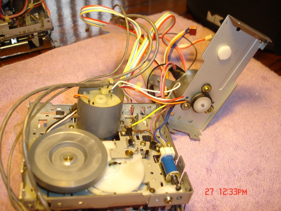

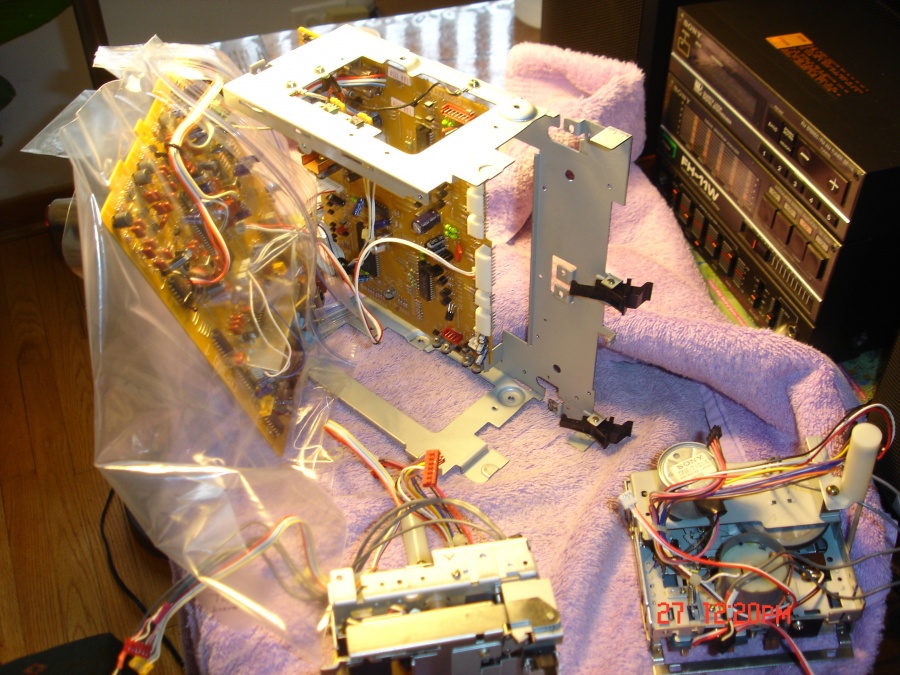

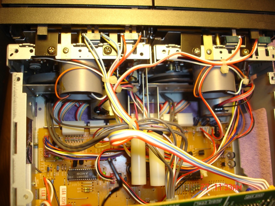

I am struggling to replace belts on the double cassette deck tc-108w of the Sony FH-11W.
:bang: :bang:
I know I can do it but it is not easy at all. The whole unit in in like new condition but the two belts are semi solid. Lucky it is not a stciky mess. It's so tightly packed and very hard to get a splinter inside. Damn :blink: :huh: design. Even the main board, front panel, cassette frame, bottom cover, top cover, rear cover, several connectors and 30 screws to replace two belts. :-O

Thats right, changing belts in this unit is really hard. I have FH10W it it took some time to change them, but its worth it
Thanks Neko!

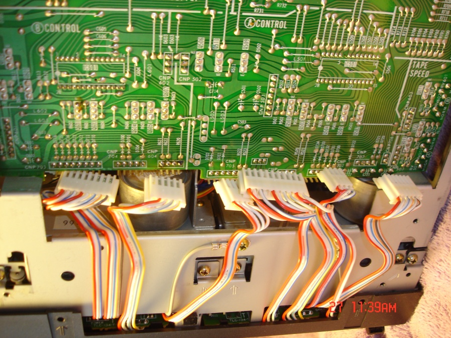

After more than 25 screws are removed :lol: :lol: both double cassette deck assembly lifts upwards from the rest of the unit. Who would have thought of it. Now I know how to change belts on it, but will wait for the belts to come in. :yes: :yes:

Now I took the challenge to fix the double cassette deck TC108W.
I woke up early to do this work.
Trust me this is not at all an easy deck to work on. I have worked on most complicated reel and cassette decks. Akai GXC-570D is one of the most complicated decks one can work on. I have two of those decks in mint condition.
I took it all apart and now need to measure the belt size and buy them before I can put it all back together.
I measured the belt size by doing some math and confirmed it by another old belt I saved.
It is 7.0" SBF. Just ordered 2 of them them from studioelectronics. :yes:
I forgot to order the small counter belt. :blush:
It is the tiniest belt i've ever seen in my whole life.
