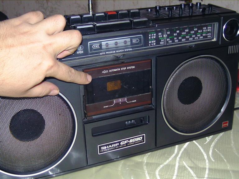

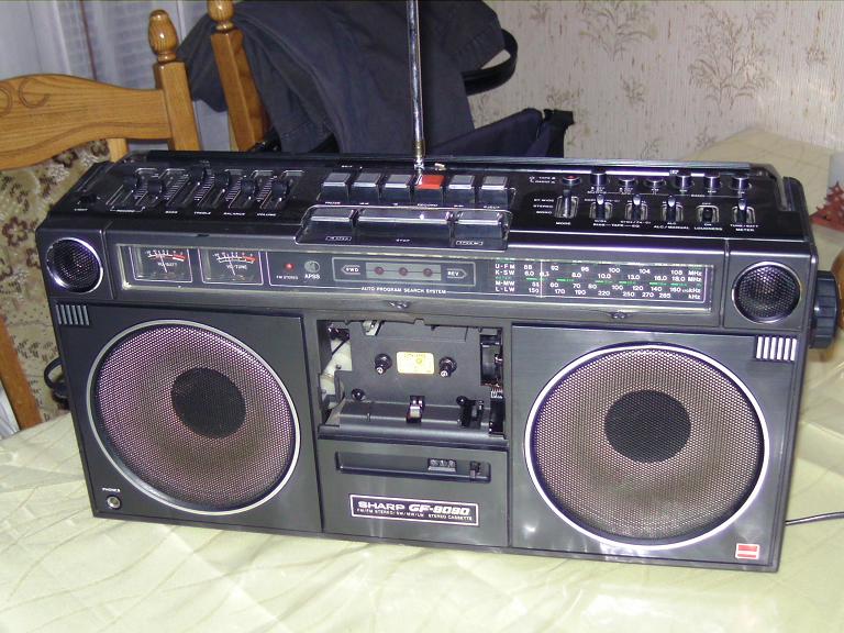

Got a time ago a broken 9090 with dead tape and missing door.
Will pull out the tapedrive, need parts for another one.
But what to do with the rest? :hmmm:

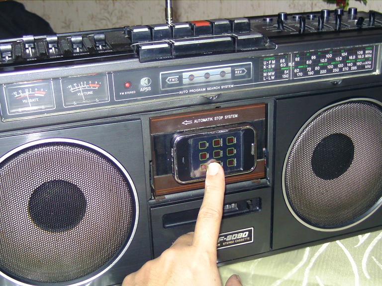

Got this touchscreen MP3 player.
Want to implant it. :w00t:
Found a door, will make it fitting to close the "hole"
the player will be mounted there
but the question:
How to connect it to the box?
It owns no line in. :sadno:
Any possibility to connect it at the old tapedrive?
Anybody done something before?
Ideas welcome. :blush:

The problem is, i want to pull out the complete tapedrive, as i did on the powerplay machine.
But the other one had linein, so no problem
A few more pics.

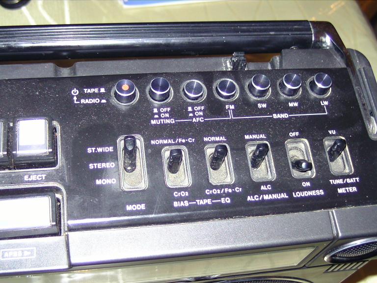

Switches:
connection possibilitys:

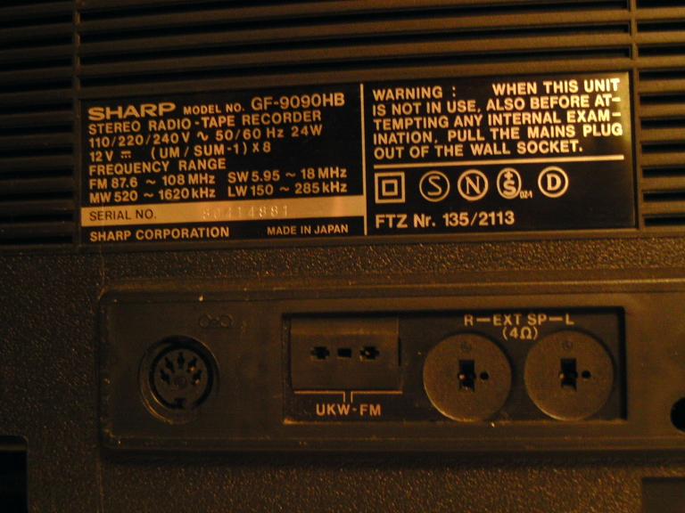

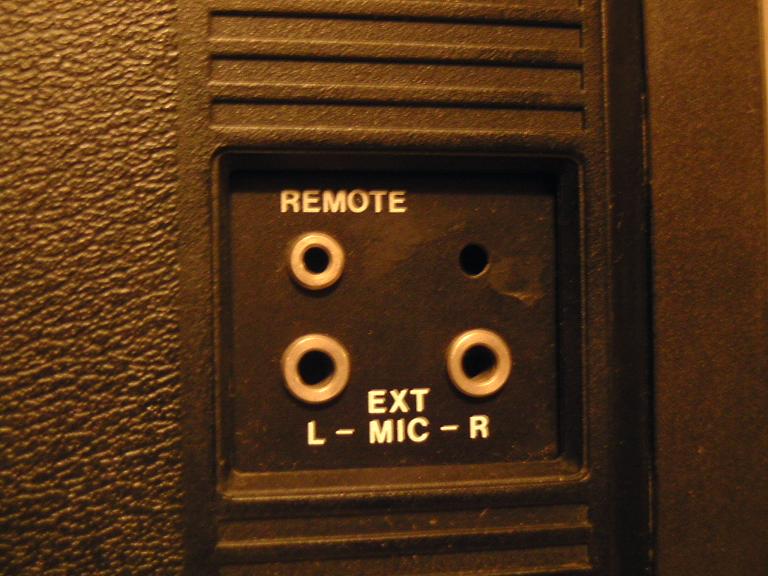

Can i hook it anywhere to the DIN or mic plug? :hmmm:
Roman:
(1) I think fatdog wants your tape counter
(2) If you pull out the entire tape drive, then you'll have an empty spot on the top where the cassette keys used to be, right?
Over here in the US, we don't really use DIN inputs much and my schematic does not show the DIN so I can't comment on that. I did however find on the schematic where the tape circuitry enters the function switch so if you like, that is the place where you would connect your MP3 signal wires. Do you feel comfortable to do this? If yes, I can tell you where. LMK how you want to approach this.
