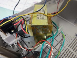

I've got the best solution by replacing transformer with the same exact size and voltage one. RX-7200 shown, I keep the original transformer shell so everything looks OEM.
toshik
Nop not in my case - it's direct replacement 120VAC transformer, any add-on converters are waste of energy, ugly and not professional...
I asked for advise and found the best solution myself while the tread went into 220VAC transformer discussion
