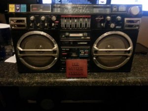

I want to start and apologize because I know the Lasonic projects are probably starting to annoy most users.
This is my first vintage Boombox and I have been looking for a few years. I just happened to log into Ebay a few hours after A Lasonic TRC931 was posted buy it now for 170 shipped to the house. I have wanted one for so long I thought about it for a few minutes and made the purchase. This is my journey.
I have to go to my Soul sucking, Corporate America, Part time job but I promise to update more with better pictures tonight.
Thanks for any help or your time given.
-GZ-

It is a crazy mess of a box inside to work on. Take your time and plenty of pictures!
Welcome to the site and we never get bored of a resto project!
clarkestrong
Jun 8, 2014
2
Thanks everyone!
My selector knob is broken. I took the box apart that night and pulled the broken gear out succesfully. Looking inside this box I have to say the assembly process must have been a nightmare. I will unsolder the box for the gear soon and put in the new gear that I am making. Would be nice to have a 3d printer for this and many other projects but for now the epoxy casting method will have to do.
I bought this box as broken, not working for parts. However the good news is the box is alive. She turns on and I moved the selector gear bar to radio. tuned to a station and she plays. ohhh man I was so excited. The right side speaker seems to make a scratching sound as the volume is raised but clears up when a volume is settled on, seems to cut out in specific volume points as well.
All in all she has all the knobs, she is not cracked even though shipper took no precautions other than two sheets of packing paper, NOCUSHION AT ALL. Very suprised it isnt broken. Needs to be cleaned and some pitting in the chrome. All the leds seem to be working. Tape decks move and the bands are in place and not cracked.
