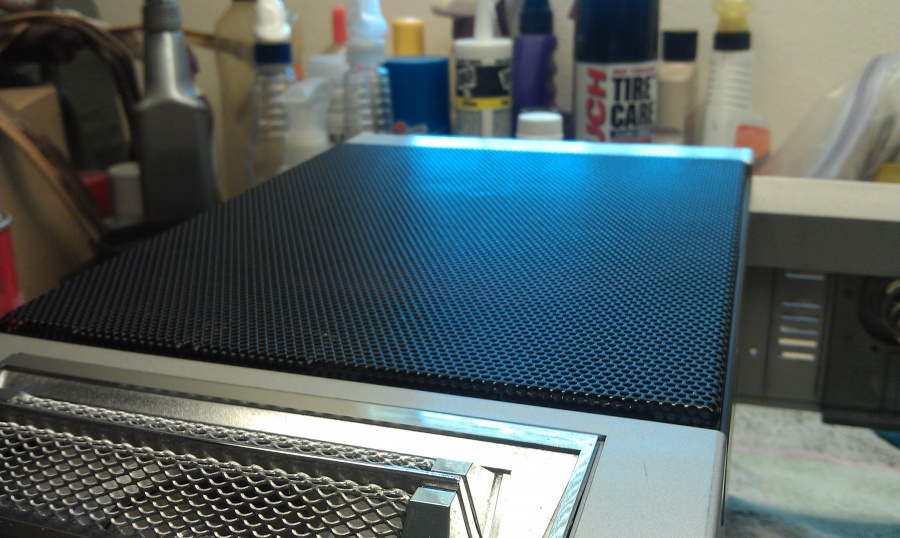

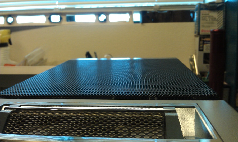

The two grills below are from a VZ I am in the middle of restoring. They were'n't totaled, but they had some dents in them that needed to be dealt with. Below are the grills I just finished. They have been straightened and painted.
They are not flawless, but they are 98% better. I went out of my way to take these pictures to show the light signs of marks on the grills. At a normal angle in normal light, you can't see ANYTHING! :thumbsup:

I have no doubt in my mind that I could repair those!
Awww, you stole that pic :-). I believe they can be pounded out too ;-)
