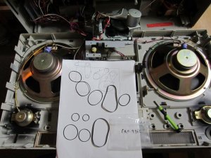

After being preempted by an automotive repair last weekend, I finally got to get into the belt job on this deck. The kit I was provided was unfortunately not great. A couple of the square belts were way too small to work in any position. In the end I ended up using only the flat belt for now, as the others seemed to be in usable shape for the time being.
The replacement flat belt was a bit tight I think. Playback was quite slow. I had to crack the factory seal on the motor speed adjuster and turn it up some. This makes sense to me. More tension equals more friction and so more drag. Since this seems to be the first servicing of the deck belts, I thought it would be closer to correct at the factory setting. I guess as soon as you touch anything in these, all bets are off as they say.
Anyway, I wrote to the seller, he asked for measurements and has sent me out replacement belts. So we'll see if he has a flat belt closer to the one I removed, only not all stretched out. Fwiw the flat belt in the kit was said to be 86mm, was actually around 90mm and the one I removed was about 97mm (folder lengths), although it doesn't stay on the crown pulley so it must be somewhat stretched. I don't know how granular the sizing is, but I'm hoping I get something like 95mm. For now the flat belt I got is doing the trick. The unit plays not bad. I think the extra tension is causing a bit of flutter but it isn't too noticeable.

...well done for hanging in there! It's frequently not easy restoring these. Doesn't help when you get dodgy belt kits - those small ones in the kit pictured are way off.
