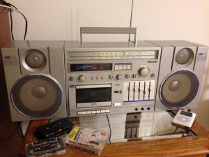

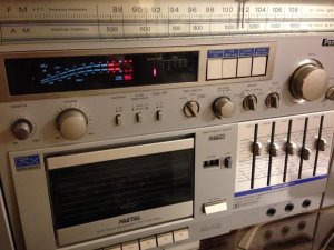

New to this forum but not to vintage radios and electronics, Recently decided I wanted a large 80's Boombox for deck parties and the beach in the summer. Luckily as soon as I looked on Kijji I found this beautiful Panasonic RX-C100, I bought it for about $75 US. It's in gorgeous condition, No rusted screws or dust inside the tape player either! It spent its entire life in a living room! Everything is intact! However it did need some work, The tape player would only play through one speaker, after a bit of trial and error I discovered the record button was causing the issue, I put a blank tape in and worked the mechanism and then it was fine, Sprayed contact cleaner on where the slider beneath the tape head was and its been fine since. Also discovered the speaker foam was rotten, I took it in for refoaming as I didn't want to attempt it on this box for the first time. However speakers need to be replaced which I am having done for $100 US sound reasonable? Included some pictures! Won't have it back for 10 days though while its in the shop :(

Yes, thanks for all the reply's guys, I initially set out to have the woofers re-foamed, However when the shop was taking them apart apparently one woofer, was not moving up and down on its own and the voice coil was damaged somehow, Prior to this they sounded alright and I didn't notice the rotten foam till I saw it on the edges after shining a flash light into it, Its possible I damaged the voice coil while cranking it up, I'm not sure. Anyway, the shop said it made sense to replace both speakers. I know it won't be truly original but perhaps the new speakers will have better bass and be more efficient then the old ones? I never really got to hear it on its original speakers as Panasonic intended as the woofer surrounds were damaged at purchase, Maybe I'm better off not knowing The shop I had taken it to is called Hamblens Audio-Video, they have been in business for 30 years and fix anything from antiques to brand new electronics. I will request the old speakers back as well! This thing is going to also been a cottage party stereo, It already impressed me with its sound and filled my large apartment at level 3 on the volume even with the old speakers! I noticed the heavily damaged RX-C100 on ebay earlier and saw it in this forum, I also saw one redone with Aiwa 40 watt speakers and while not original, seems very nice as well! It seems people have varying opinions on speakers being replaced. I will take more pictures of it when I get it back so you guys can see how beautiful this one was kept, No evidence of ever being in a damp garage or basement, inside the tape player looks new and the head is flawless! I'm guessing the belts were replaced at some point as it is working well.

Got my boombox back, Can't figure out how to add more pictures to this thread? help? Anyway it sounds wonderful! Lots of bass, no rattling or anything, and I think the speakers have a higher sensitivity then the old ones too!
