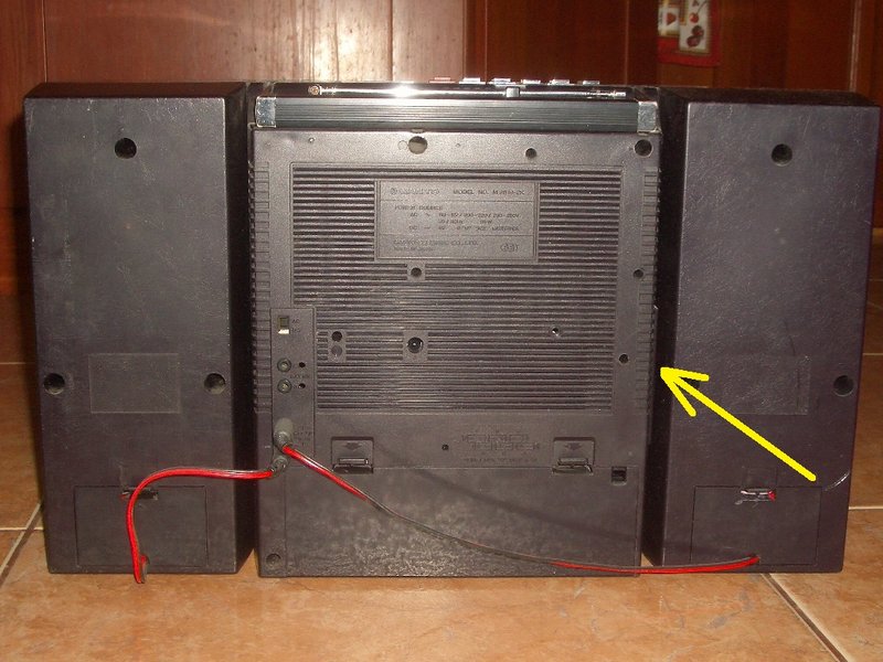

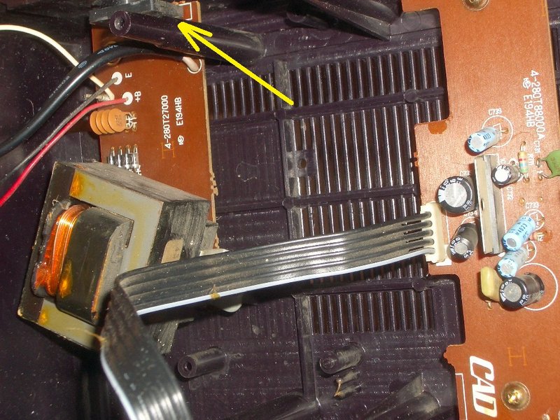

Yesterday I googled about Sanyo M9819-2K and found photos on a russian site: HERE
On the back of the case is written 110-200-230 v., which means that there must be a hidden switch.
Take a look at the following 2 photos: A yellow arrow shows something that is like a switch.
It should be on the narrow side of the radio - you have to take down the left speaker and look for it.
And what is the end of the power cord? Show photos. Did you buy it from Europe?
