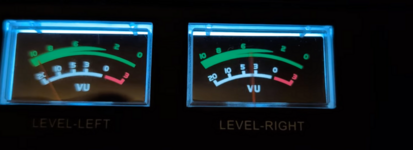

With some cassette tapes, there may be a difference in the signal level of the two channels - one may be louder than the other.
When listening to this cassette, did you feel that the left channel was quieter?
If so, then it is normal for the level of the VU meter to be lower. What is the situation with radio or CD?
beansmaynard
I've spent the morning doing some testing. Some of my homemade cassettes show on both VUs but some don't. I've checked them in other boomboxes and they're showing on both channels but on the Camden they're not. Unless, I'm missing something. I record all my cassettes in audacity, in stereo, using the same settings I've always done. My prerecorded cassettes always show on both VUs.
Is it the Camden or something else? I'll have to report back.
Both the radio and CD always show on both VUs.
