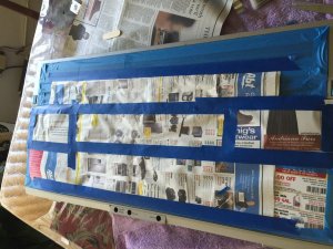

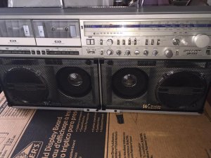

Six months ago I bought a mint Sharp GF777 but arrived all broken and non working. The broken radio parts were inside the box and also shattered plastic case sections. Luckily it didn't tear the speaker cone.
After carefully examining and removing broken parts I powered it on. Cassette was working but one channel totally out so also radio had issues. The tuning cord was hanging down and found the weighted wheel for tuning all broken to pieces.
I started getting parts one by one and finally fixed it all.
I postponed fixing the broken case for a while but seeing the temperature plunging to 40 F soon I had no excuse. I had to paint it soon.
It took a lot of patience and effort to fix all and put it all together. Luckily I found no screws in excess.
Now it looks great and works excellent!
I had to replace the main amplifier, radio board, weighted flywheel assembly, re string the cord, glue all broken pieces with 2K epoxy and JB Weld, open up the pots and clean and did deoxit treatment, and then
paint the case and the front grills.
Re stringing the tuner was not easy but I was lucky to get it done in 10 min. First I had issues the tuner wheel slipping a little bit, but pulled the spring to the next hole on the tuning gang large wheel made it all work well. That increased a little tension and solved the slipping on the 5 turns of thread on the tuning wheel axle.

Thanks! :-D :-D case restoration was done first with Gorilla Glue 2K epoxy and then with JB weld, used glazed putty to level and wet sanded with 320 grit emery paper and later with 600 grit. I used a nice block of smooth oak wook piece under the emery paper for sanding and not the sanding block. This way it will keep everything in the same plane and broken side look smooth. Used plastic primer, Krylon Al dull paint over it followed by matte clear coat. Thanks to Jimmy for all his advise!
I learned a lot working on this GF 777. Restringing the tuner cord, opening and cleaning all pots, replacing main amp, installing new belts (thanks to Bobby's Instructions), replacing tuner flywheel assembly, fixing the power button, and a lot!
