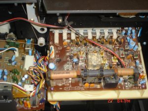

On another note, I think I may have damaged the antenna connection. I'm pretty sure it's not supposed to just dangle like this...
Any suggestions? The fm radio seems to work fine, but knowing the chord is hanging inside the box is going to bother me. At least I get to enjoy the sound quality now, and it thumps pretty hard without creaks or rattling.

That cord dangling for the antenna hookup plugs into the radio tuner board. You didn't damage it.

Thanks for the info! Do you happen to know what the radio tuner board looks like, and i would just plug it right in I assume?

Here it is ..
On the right side looking from the back of the M90 you will see a board shown in the pic. It is the tuner board. Right next to the ferrite rod you will find that male connector with 3 pins sticking up.
Do not do any cleaning or tampering on that radio board. There are parts that are buried in molten wax. After tuning and aligning manufacturer sealed it with wax or else it will mis-align tuning.
I have circled the place on the board "CN2-P" which is the place for the antenna lines to connect.

Amazing, thank you so much! I love this forum.

Success! I located the pins and it is now connected. Huge shout out to everyone who walked me through this, I truly appreciate it.
I'm glad it all worked good for you.
In future when you open up any box remove the cover very slowly. Some boxes will have several connectors like this one which needs to located and disconnected. Make sure to take pictures of those connectors before you disconnect and save it under that boom box file. This will really help a lot!
