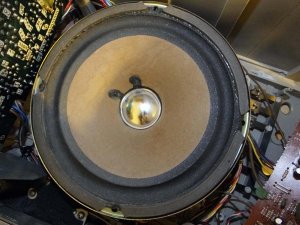

Same here, I have 777 with brownish speaker cones. I've seen dark grey and black cones, I think maybe dark grey is the right color because if you look it from the behind you'll see the same color!toshik said:Let's lift up the older thread - how would I know what was the original color of speakers cones on Sharp GF-999?
For example, on National RX-7200 center parts are originally brownish paper with only black surroundings.
Painting this into black would make it look fresh and at the same time completely ruin the authentic look.
