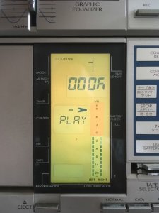

No I haven't tried it for an LCD repair.
This looks incredibly promising, because it is able to double side, glue multiple points and not create cross connection between near points. Can be cut to required strip size. I think you've found the solution product longman! Going to order and try it on next PC-55 display that needs it.
