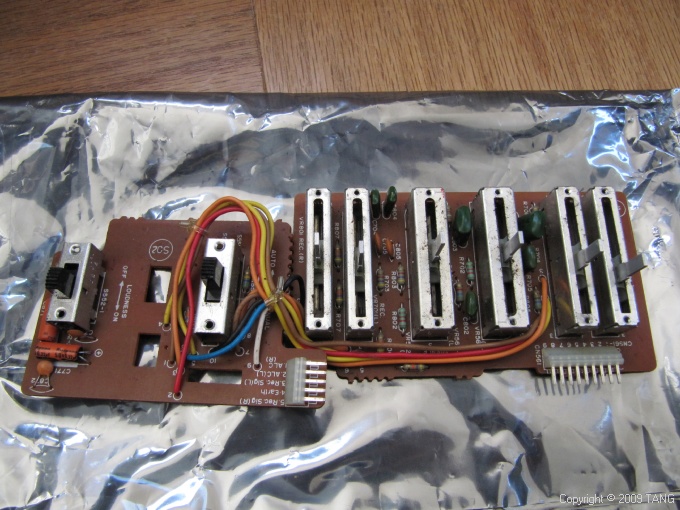

I immediately suspect that the tonal control board is shot (the sliders are the bane of this model) and needs rebuilding. The sliders themselves are no longer available, from any source, so they need to be removed, disassembled, and painstainkenly restored. If you think the belts are hard to do, then I suspect rebuilding the tonal board is probably not a diy'er type job for you.

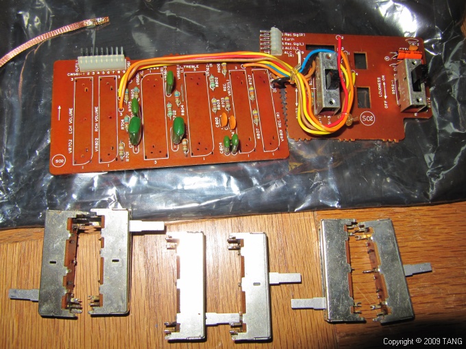

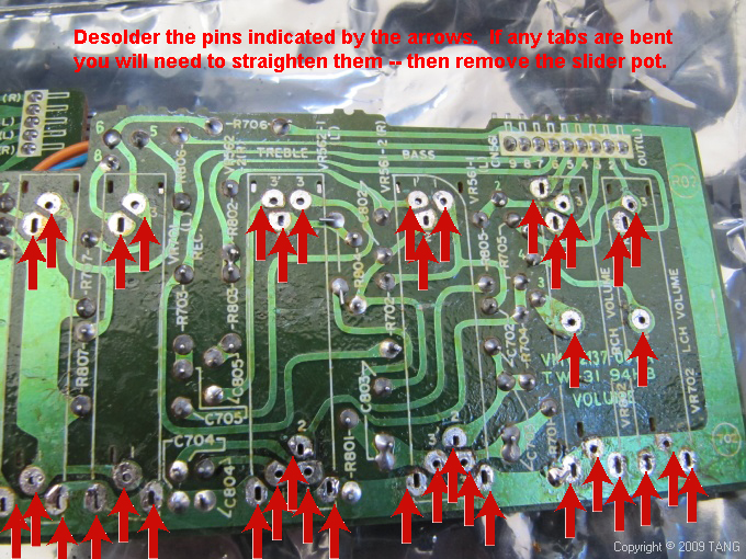

Can't really give you an enumerated procedure. You either know how to do it or not. But basically, this is the board we are talking about (if that is what's bad in your case). Basically, remove the board, remove the sliders, disassemble the sliders, rebuild the broken pieces. Check the resistor board for proper continuity. Repair any broken traces on the board. Replace the capacitors on the board. Then reassemble.
Oh, and the resistor strip? There is NO replacement. If it's broken and no longer salvageable, then you'll need to find a parts box and hope it's rebuildable. That is one of THE items on the board that needs to be salvaged and repaired during the rebuild. It has a unique tonal response curve that is not standard so even if you found a replacement that will physically fit, it won't perform the same. The original parts were discontinued long ago. So if it's bad then you'll need to try to repair it. Also, the parts that's almost always broken are the feelers. The original Alps design was terrible, and they break off pretty easily -- even on new ones that have never been installed..

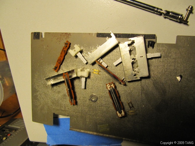

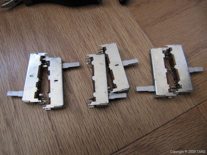

You are so right! This evening I took out both the sliding pots and when I opened up to check the pot with the 1/2 volume issue, I could see that the carbon resistance strip had a hairline crack right above the 1/2 volume (center tap). When I checked the resistance from the center tap to one of the end connectors on the carbon strip I was getting a resistance value of ~24 K ohms. When I checked it from the center tap to the other end, it was found open. I slowly glided the DMM probe “very gently” (taking care not to scrape off the carbon) over the carbon strip I found the place where it was cracked; beyond that point there was no resistance reading at all.
If I use conductive paint at the crack will it join it? Just wondering how I can fix that crack on the carbon resistance strip.
Now the other sliding VC resistor looks good to me. It gave me a 50K ohms value when I checked. I was wondering why that channel volume is not maxing out. I would say it is around 2/3rd of the M70 channel volume. I didn't open this slider control yet.

When they start to go, it's like an avalanche. Just FYI, the volume, bass and treble all affect the sound. You already took one apart. You need to take them all out, clean them one at a time, then test them individually. A failure in any one of those pots will have an affect on the tonal quality and sound output level. Also, I never saw a resistor board with a break in the carbon. Always at the connecting strip near the ends. There are compounds to bridge the break. There are flexible carbon based ones, designed more for repairing rubber buttons like those in car remotes. Then there are acrylic based silver compounds that are more durable. But none of them is going to be very durable with the feelers rubbing them all the time.

As a desperate attempt I will try using the silver conductive paint to fill the hairline crack. I don't know if it will even get inside the ~0.2mm cleavage. The particle size of the silver dust looks much bigger. I hate to make a "V" cut to accomodate more paint there. I cannot think of a way to electrochemically deposit copper or silver there at the crack and level it off without making a bump. This is a real challenge! The feeler tips looks not that agressive and they still have the curved and smooth stylus with good spring action. :hmmm:
The silver paint, especially the ones with pen tip makes pretty wide swaths (approx 1/16" at least) so use sparingly. If too wide, you will diminish the resistive value of the board. Then it will sound weird as the volume increase normally, then all of a sudden have a lull in the response curve until it starts up again.
There are 2 competing products out there that I know of. One manufactured by Caig (the makers of deoxit) and one by MG chemicals. It's my experience that the MG chemicals one is a better product (costs twice as much) as the acrylic finish seems more durable.
