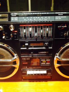

i found a lasonic Trc-931 could you advice me, thanks
pawaii

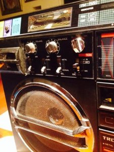

Mi name is Gabriela and i found this in someones basement, could you advice me about it, the cassete works and sounds right, the selector button dont work :(
i posted this in other thread and im sorry, yeah i want to sell this, but i just ask for some help for doing it, sorry okay????
thanks

We will not tell you how much something is worth. The only way to figure it out on your own is to search sold auctions on ebay.

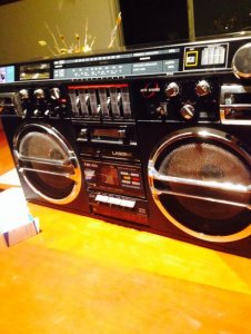

You have a 2nd generation Lasonic TRC-931. It is the 2nd label design for the 2nd generation Lasonic TRC-931.
The broken selector switch is a very common problem that these brand boxes suffer from. It does hurt the value a lot. Everyone is looking for a 931 with a working switch because there is no quick fix for a broken one, which is sad.
All corners were square until the "3rd" edition came out.
1st edition:
Led's on right
2nd edition(s):
Led's on left, dual antenna, brown power button decal
Led's on left, dual antenna, yellow/blue power button decal
Led's on left, single antenna, yellow/blue power button decal
(these also had variations for the position of the headphone jack, not sure which for what without searching, autoreverse decks, and other small details)

Anyways. It is a very fun boombox you have there, but like blu-fuz said, with that selector broke it won't be worthe much. It's a near impossible fix.
I tried it once and got it to work, but it was extremely time consuming and not worth doing. I would suggest using it and enjoying it. If it's stuck on tape or phono, you can plug in an ipod or similar.
They sound great, use it. You'll love it.
