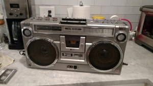

Hi All,
Just wanted to pop in for a quick howdy. I found a Sharp GF-9292 at a yard sale a couple of weeks ago. Finally took it apart and cleaned it yesterday. I ordered belts and the new capstan roller so I'll get the cassette deck working soon. It sounds great, and looks pretty good too! I'm pretty excited to have it.
Take care,
Ed

fast_eddie_72
Hisrudeness said:
These are one of the best looking Sharps.
Did you manage to get behind the speakers grills and clean it?
Not yet. But the speakers are very easy to get out. I had it mostly broken down yesterday. I concentrated mostly on cleaning pots and switches to get it working well. I'll do more cosmetic cleaning when I have it apart again to do the cassette deck maintenance. It's a great stereo to work on! Very easy to break down. Everything plugs in and unscrews easily. Much easier than a lot of vintage receivers.

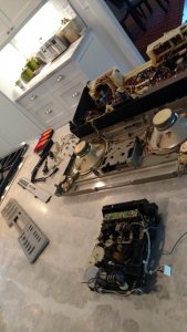

The picture above was actually the day I brought it home. This is how far I got yesterday. But it was so easy I put it all back together so I could enjoy it while I'm waiting for parts. I shot a short video of it yesterday afternoon. I'll post it on youtube and post a link.

fast_eddie_72
This is it yesterday afternoon, cleaned and working well. You may see in the first pic above one of the sliders for the recording level is bent. I did manage to get it straight with two pair of needle nose pliers. I really hate bending those things. Always afraid something will snap off. But this one went well. You can see it now straight in the video.

Transistorized
That's a nice looking box. Love those huge dust caps on the speakers. They look mean :-) and the front Inputs are a unique option. Makes it easy to connect devices
also...its nice to know I'm not the only one to use the kitchen counter as a workbench..lol
SLO
I've always liked the looks of these, especially the trim rings around the woofers, great score, and welcome to Boomboxery

Congrats on finding a nice 9292 - I especially like the real steel mesh tweeter grills - quality stuff.
When you do the deck, don't forget to replace the 5mm tubing to get the playback working right.
Good luck with the service.
James.... :-)
T-STER
Lovely box the 9191 and the 9292, classic killer looks and a nice feel to the controls. As Jimmy said replacing the capstan sleeve is important, if it hasn't gone already it soon will, its an easy job to do while its all open to.
