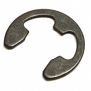

I would make channels on either side of that nylon, and slip a retaining ring there. Take care not to dig too much for that channel to slide the retaining ring and hold it there. Nothing would hold that nylon piece that is already cracked. Additional Glue application will make it more stronger.
