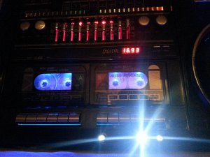

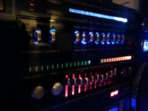

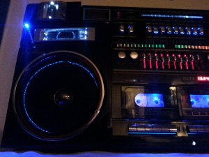

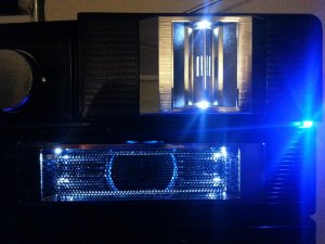

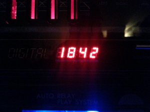

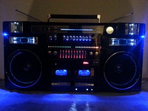

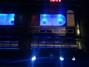

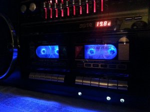

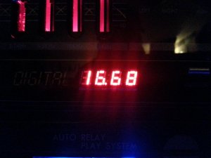

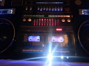

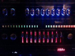

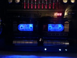

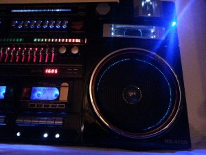

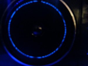

I just realized only the glow wire around the speakers and cassette keys were sound activated. I thought it was all the lights. I like. What about in the center, is that a factory meter or is that added? I don't know too much about the 4700, but this and the other resto you did in December definitely caught my attention. Now added to the list.
hemiguy2006 said:
I was wondering about the meters as well. Those are sick
The center horizontal lights are factory. I wouldn't call them "Meters". They are sound activated incandescent light bulbs kind of like the Discolite.
But they act very strange. There is one light bulb in the middle and one at each end. The center one has a blue cover over it, the left is yellow and the right is orange. Each one is activated by a frequency, Mid, Low and High.
What looks like a bar of lights is actually a row or prisms that give it the effect of LED meters.
But the problem is, depending on the song and the tone in the song, sometimes only the lights on one side light up until all the frequencies come into play.
I may change the colors and balance them, so both left and right are mids/red and the center is lows/blue or something like that to give it symmetry.
Here you go...

fromNKLwithlove said:
Wow, that really looks awesome! I really like the illuminated buttons etc!!
It looks so out of this world in the pictures, I just can't wait to see this one in person! OUTF***INGSTANDING
caution
Congrats on closing the deal a long project, always feels good!
Very innovative, it's in a class of its own with the attention to detail. The rainbow meters really add a nice touch! :thumbsup:
Northerner said:
Holy smoke that is frickin awesome! So many hours involved in that monster, totally love it :-)
It's hard to say how many hours. It took 4 months. I was fairly diligent about working on it during the day when I had time and 4-5 nights per week, 5-6 hours per night. No less then 60 hours, no more that 100. It was an @ssload, that's for sure

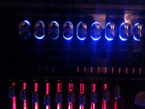

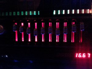

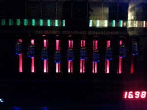

Thank you, the EQ and the buttons were the hardest to do and took multipal setup's to get the light to shine through at the correct angle to make it happen
