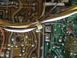

I believe it could be a bad soldering at the back of the PC board. It lifts off, disconnect and cause issues.
Let me look for my link about it.
Here it is.... go to page 2. See that two copper wire connections? In my case one of them lifted off/ disconnected.
You have to get behind the main PC board to fix it. Just remove screws holding the main PC board and carefully slide it to the front. No need to disconnect any wired from the PC board except the plugs for the cassette mechanism.
both the boards and somehow break off at the solder joint from flexing)
I removed the two copper wires ( you can see them next to the plastic tie in the picture. They are rigid wire lines connecting ) and then used flexible wired and re soldered it. Problem was solved!
