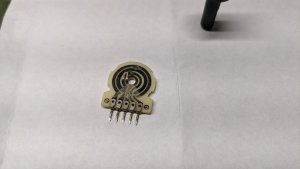

Here's a shot of the inside of the new pot.

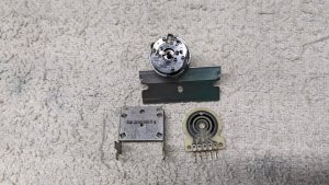

Here's the old pot, new pot and another of the new pots on the bottom.
I had to cut the shaft down and lengthen the flat part to allow the knob to slide on correctly.
Here, I'm comparing the old and new pins.
You can see how I had to bend the pins to go through the board.

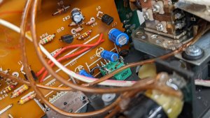

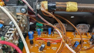

Here's a shot of it soldered on the board.
The 4 blue caps are new, I replaced the old ones just because they were in the volume pot path.

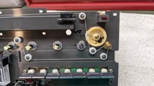

Finally, this is after I threaded the tuner cord back on so you can see it in relation to the other pots.

Here's one more overhead shot to see how the two pins are going through the board together.
