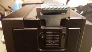

Taking my grey JVC strap I got from you in Vegas to Venice tomorrow to click it into my new Dream Box I am getting from Reliblu_fuz said:I don't stock any 2" because all the JVC hardware I cut out is for 1.5".

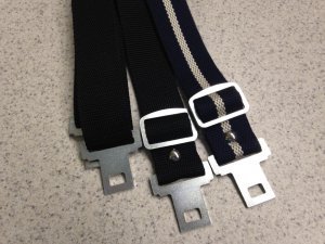

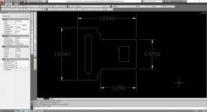

Here's what I gotblu_fuz said:For now, check to see if these dimensions work on your new JVC of the 1" strap hardware.
M70 1in hardware.jpg![]()

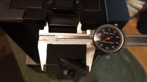

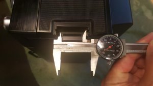

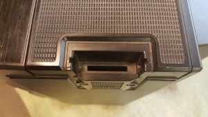

Here is the internal channel measurement.blu_fuz said:I think the 1" strap hardware is exactly what you are looking for. Your mic is showing about 1.63" BUT your box also has a wider slot opening for the actual hardware to slide into on each side. My measurement of the M70 1" strap hardware is 1.654". I bet it slides in perfect.

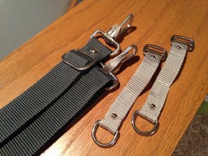

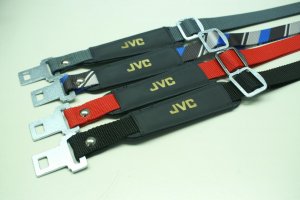

Don't you have an old 1" strap I put together for you years ago? There was about 20-30 1" style that I put a JVC shoulder pad on too like shown below.
PICT0121.JPG![]()
Cool, let me know what you come up with. Thanks Joe!blu_fuz said:Yup, the smaller hardware/strap combo will fit your radio. I will see if I have any more sets here. You could also use the small 1" strap hardware and just use a 1.5" J-hook strap through the slots of the hardware....
