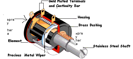

when spraying the cleaner / lube ,it's best to go into the small holes located on the backside of the pots ,these holes are where the tabs on the pot housing are bent over to hold the inner parts in place ,usually 3 or 4 tiny holes .just use the straw / tube that comes with the lube to get into those tiny holes. just be careful that you don't spray too much , you can test spray it in the air to test how much comes out of the can when you spray , usually only takes a tiny amount of spray , too much makes the pots too loose and the knobs turn too easily.
it's best to use sparingly and try to limit getting it on other areas and if you do just dab or wipe off the excess cleaner with q tips or tissue paper . once you have lubed the pot just turn it back and forth to work the cleaner , lube into the parts better .
