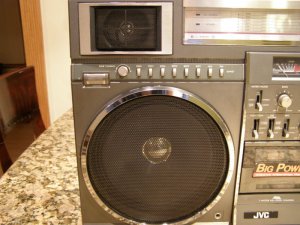

See a picture of M90 with the wrinkled dial in the picture. It went for $2950 couple of years back.
You can see it clearly on the top right part.
See also another one with the wrinkled dial.

Miles, We like to see pictures of it from 3 angles, one from the left corner, the center and the right corner. It is hard to believe they made thicker dial plates on Victor. :no:
The glue JVC used shrunk and pulled the thin Al plate to the mounting bracket. This is the cause of the wrinkled look.
In most boomboxes the dial plates are mounted on either ends with screws. So, none of them had this ugly look.
I've seen the same issue with my Conion C100 F (Korea). The front plates with the controls are also pulled in where they applied the glue. One only notice this defect from far when you look at a glancing angle, the same way you look for defects on a car.
