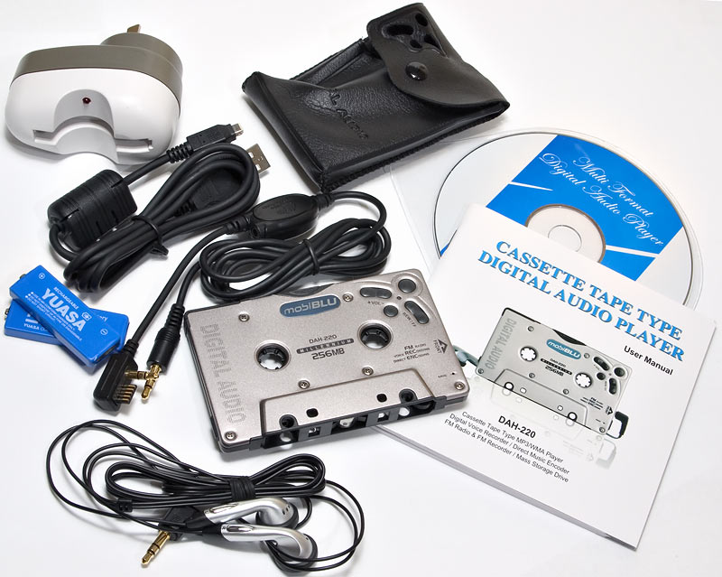

I haven't played with a bluetooth cassette yet, but it would allow you to tether to your smart phone, which would then have all the player capabilities there. They're considerably more expensive, though. I've seen some take bluetooth headphones and install the guts into a cassette adapter. The other downside is that the phone would have to stay close to the box at all times. The mobiBLU mp3 cassette that came out ten years ago was nice, it would be great if it was refreshed with a usable amount of storage space and not have weird software requirements.
