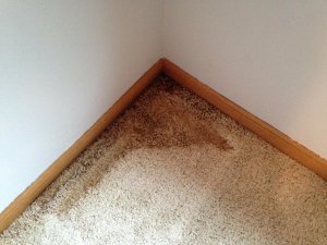

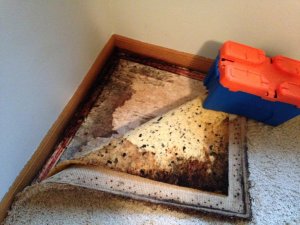

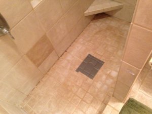

Everything is going well, and only one big shiatty surprise with the house. The master bath shower pan (tiled shower) is leaking. Not the drain, but the actual water proof membrane/concrete pan. Leaks water into our son's room on the other side of the shower wall, leaks through the living room ceiling below the shower, and leaks into the hot box surrounding the fireplace behind the brick. What a crock of shiat. We plugged the shower pan drain and filled the pan with 1/2" of water. The water leaked out in less than 15 minutes through the cracks in the tile/grout/pan...... crap.
Luckily there is another bath/shower to use until I demo the master bath shower and build a new pan and re-tile it. It will be OK but I hate finding stuff like this that the previous home owner had to know and didn't say anything. Makes me want to kick him right in the dick.
The hot tub had a pin hole leak too that I found. The water was dropping about 2" every 5 days. Luckily an easy fix and not on a high pressure line. All good now.
You can see by the pictures that the shower pan has been leaking for a loooooong time. Subfloor in the bedroom next to is is soft, tac strip is disinegrated and rusty, looks like a bit of mold, and stained carpet/pad.

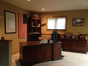

And my favorite place is the office area. She's a beaut!!!!
