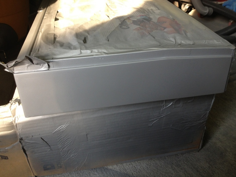

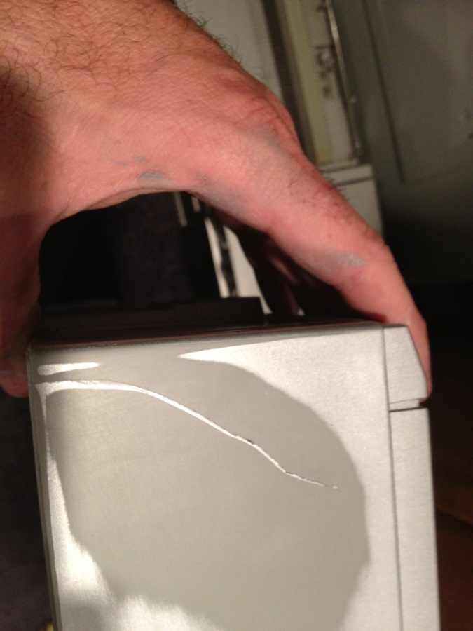

ok got some good news to report....just got the box back from the shop it now fully works :thumbsup: :thumbsup: but it is still a little ruff,,,as far as the crack in the casing i glued it back together ...I waited for that to set up over night so today it looked pretty good so now i began to fill the hole in I reinforced the back side using a plastic card and jb weld on the inside as far as the outside i put a thin layer of epoxy on the outter cassing so far so good ...radio is fully torn down the back got some special treatment to ..it was cleaned sanded washed again dryed , primed and painted this afternoon here are a few pics.

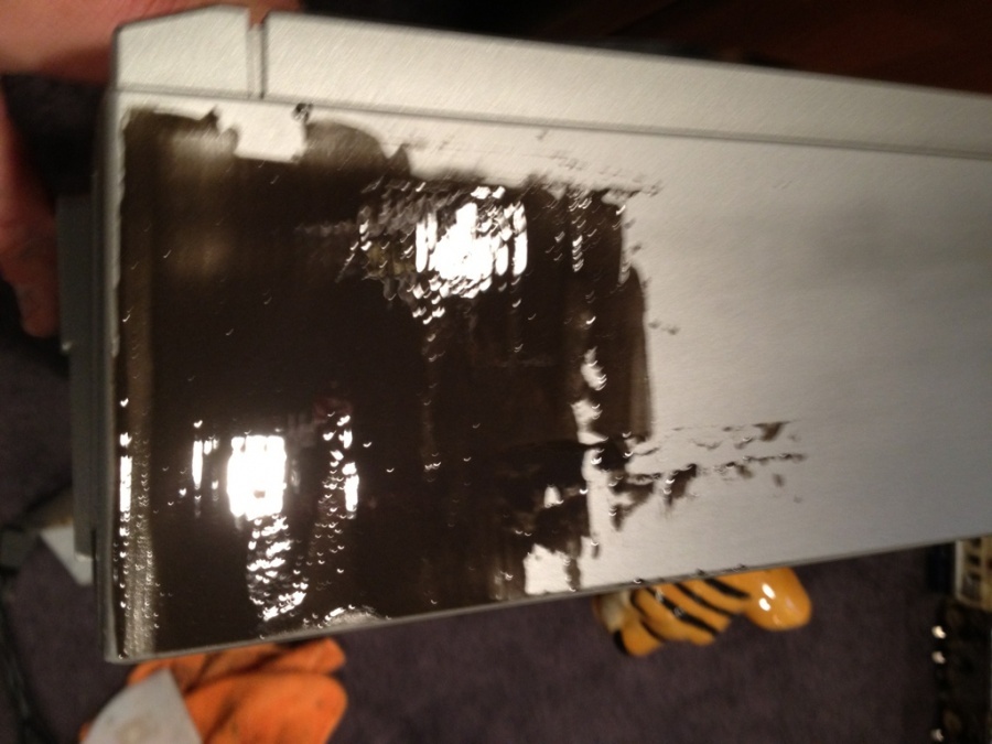

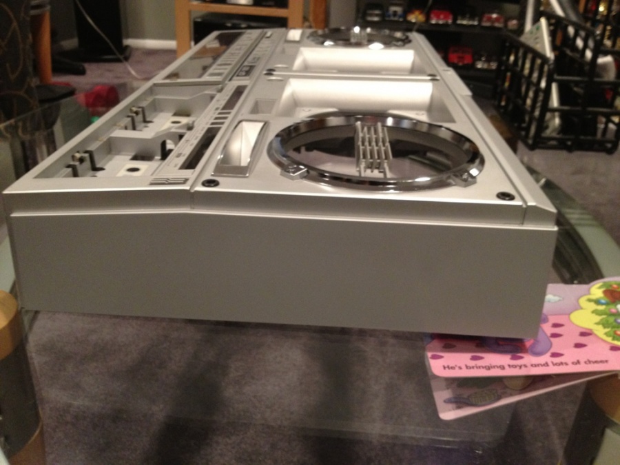

ok just got done doing thepainting....the best part of this is I was able to save the sticker from the back of the old cover :-D :-D so after a few hours of sanding because i used to much epoxy on the side :dunce: :dunce: I was able to paint this beautiful box :breakdance: here are a few pics of the progress

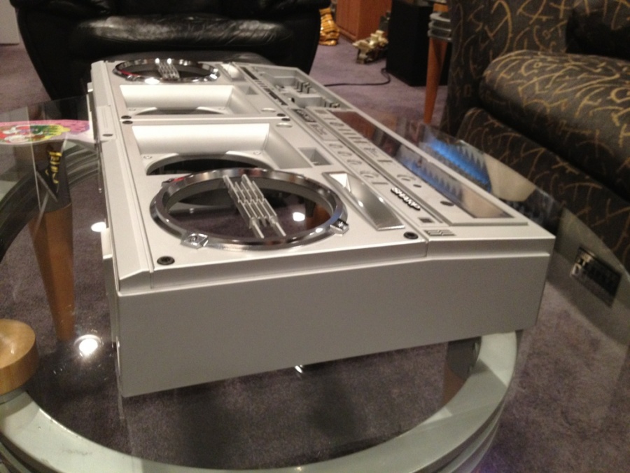

good morning to all...im finally done with my restoration :thumbsup: :thumbsup: :thumbsup: well almost.. gonna try some different speaker options but in the mean time the woofers that are new really sound good it is a much more bass'er sound also a little brighter with the real tweeters..im just so glad i was able to save this beauty dispite all the problems I worked really hard to bring this one back to life ...bobby thankyou so much for the labels they really complete this box and put it over the top.I was able to find the owners manual for 767z this one is an E but its better than nothing :dunce: here are the finished pics
