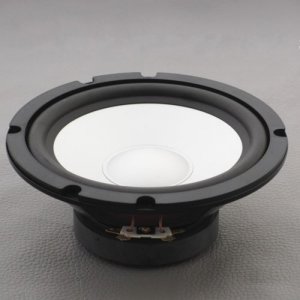

Few other 2ohm and 4ohm speakers I am looking at. Will likely keep the sharp 1000 with the 4ohm (due to 28 watt amp)
May do these for the 1000 inners and outers
Cpl-Chronic
The white cones in the last pic look so fresh bro! I bet they are a good no nonsense woofer, perfect for a blaster....
Uh, I'm not positive but I think the 1000 is the same amp, just different rating system due to advert laws of other countries. In North America it's OK to lie & quote a 100w with no reference but in some other countries it has to list the actual real world RMS rating.....hence 28w @ 4 ohms but at 2.3 OHMS that jumps to about 45w maxium....CHING!!!!!
