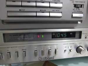

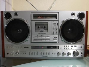

What can I say? It's an amazing one, great design and sound, especially comparing to my childhood tiny RQ-4050FD...
Both original 76-90 Mhz and 100 VAC are quite disappointing.
FM due to the fact that it only picks 2-3 stations from the bottom of the US band around 88-90 Mhz.

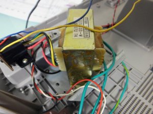

100 VAC is simply a disaster area - RX-7200 is made to work off 12-15 Volts DC as noted on the back.
When plugged into Florida's 120 VAC outlet (outputting about 125V) the internal transformer outputs 17.5 VAC as a result!
After the rectifier bridge is sends pretty much fatal 22.5(!!!) Volts DC to the main board which would kill the 33-years old beauty quite fast. It can run off DC adapter, but most of recent adapters are switch mode not linear, so they would cause extra interference plus it's large external non-OEM piece.

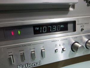

I took care of both issues so now it has full coverage on 88-108 Mhz with correctly displayed frequency and normal power voltage. What else can be done? Full re-belting is done, pinch roller replacement is pending roller arrival.

Nice work getting it switched. Curious to know how you got the FM range to change....?
toshik
Mar 1, 2015
500
2
18
57
St. Augustine, FL
100% Japan model the only reason they have the first "1" is because of AM indication.
It was made before 1990-s when decontenting and penny-saving policy started.
It took a couple of days to figure that out :-)
In a good company alone with RQ-4050FD - 1.5 months of collecting.

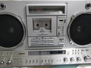

Speaking of warm white LEDs strip - I gave it a try tonight and I don't like the results...
3-LED strip is about 2" long and there is simply no space to conviniently lay it out against the edge of light carrying acrylic sheet where the OEM lamp was. Also since the LED consumes only 3.5 mA off the 9V light supply when the switch is turned off it dims VERY slowly - must be a cap somewhere in the circuitry.
I think I'll go authentic filament lamp. It only consumes 35 mA off 12 V source.

I can only fit one LED into the space ao I'd have to come up with new current limiting resistor. 7000 circuitry might be different without cap need to look at service manual.

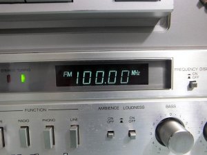

Ok tonight I made it absolutely perfect - took the display to a full extend!
I added the hundredth (.X0/.X5) Megahertz display segment so we have a fully-blown display so tuning makes sense now (you know the exact frequency you tune into).
Not practical in the US where we use only odd frequencies, but correct indication alone with being very very sweet looking :-)
