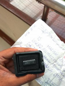

Hey guys, nothing has been done yet. Cleaned the boards and stuff. thats it. One of my friends in US will order the speaker surrounds for me. It will reach me by August hopefully. Will be getting the mechanical control IC from ebay.

I am going to graft some plastics on top, thats the best option for me. Waiting for my tool kits to arrive. Till then the project will be in idle.
