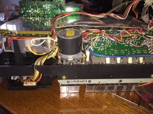

Those 4 white deck function switches are internally spring loaded and flip backwards when you remove the small PC board. We have to move it forward so that it works with the tape function levers, when you put that board with the switches and mount the board with two tiny screws.
I used an old credit card to move them all the same way and place it over the tape function levers to mount the board. A metal bracket holds that small board.
It is very easy to lose those tiny screws in the box. Use a magnetized screw driver for those tiny screws. Or simply magnetize one by making strokes on a magnet. Just drag the screw driver tip from one pole to the other pole of a magnet, lift it away from the magnet and repeat the process like 25 times to make the screw driver magnetic.

Awesome!!! It's so great when a big issue actually is only something small ;-)
Exactly! Thanks Bill!
