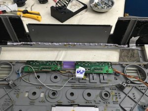

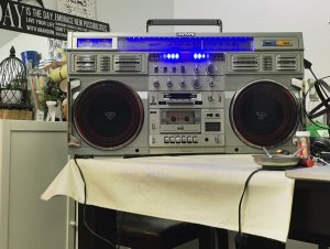

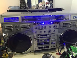

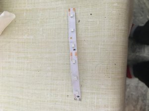

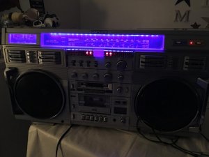

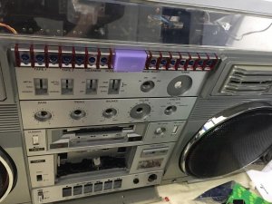

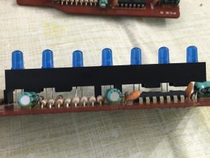

I have finalized the tuner installation ( LEDs ), here is the current position. I'm not happy with the way the LEDs can been seen at the top of the tuner glass.
Perhaps I'm over thinking it..... What do you guys think?

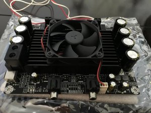

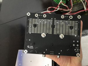

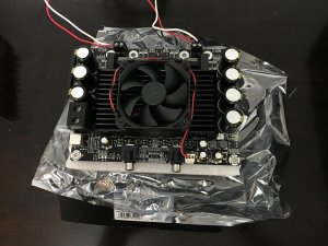

So now we are current with the project. I received my amplifier and power supply and will be doing tests with this weekend. I'm confident the amp will fit in the case easily. My concern is the power supply. The unit i purchased is for testing purposes and is the a great external solution.

2 Great questions. with the current setup ( excluding the amp ) yes it will be able to be powered by batteries. Due to the voltage needed for the other amp I will need to do more tests to see how the amplifier preforms at 15v, which is within its operating range. Obviously it will not be able to supply its full wattage on 15v.
My goal would be to use the existing tuner. But that being said I'm looking at digital tuners that i can fit inside as an option. I would get acrylic cut to black out extra space. Not best case scenario on this unit - I want to keep it the way it looks.
